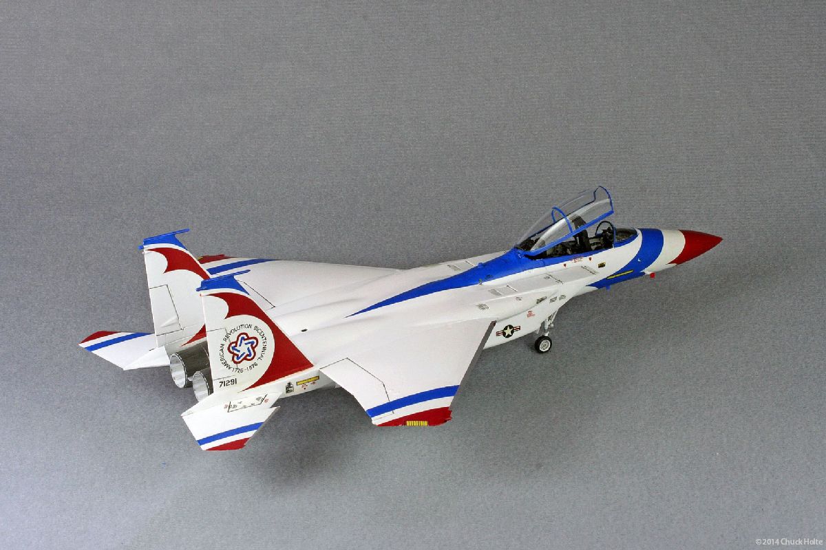

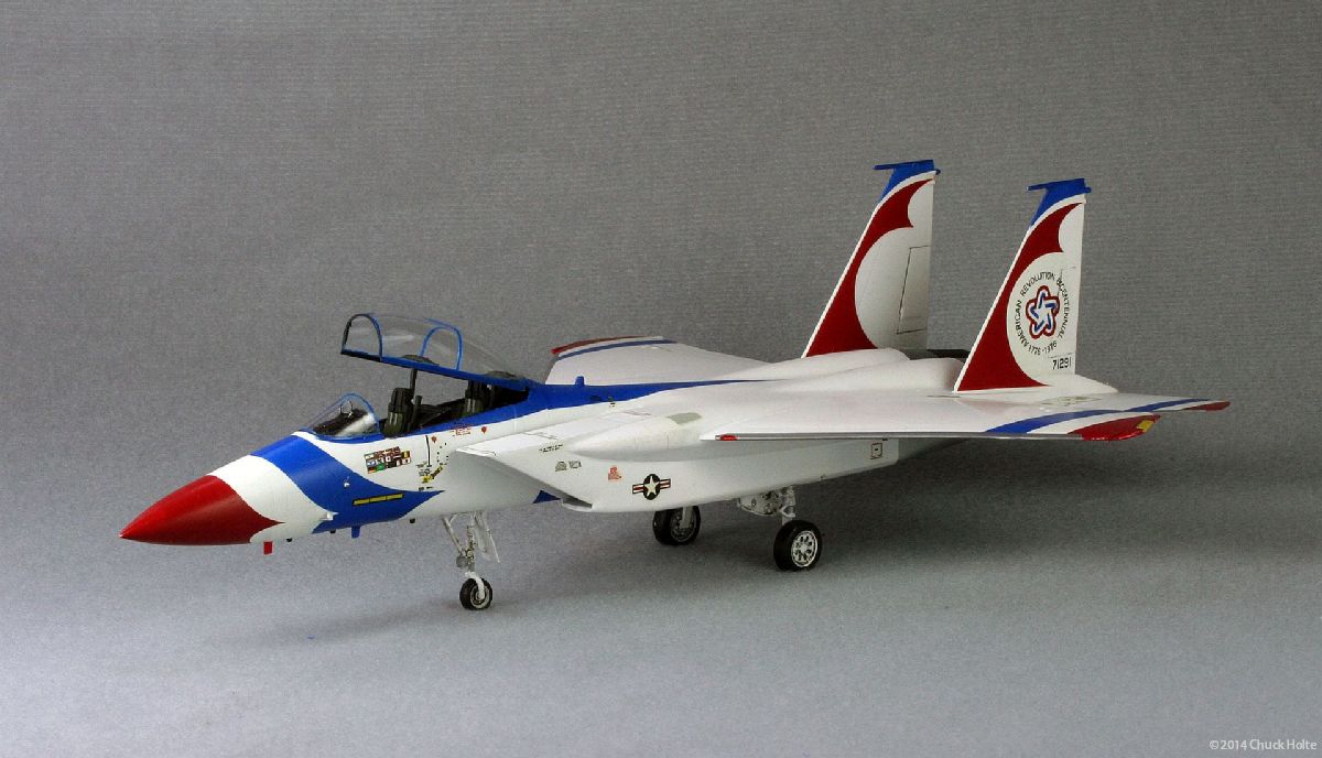

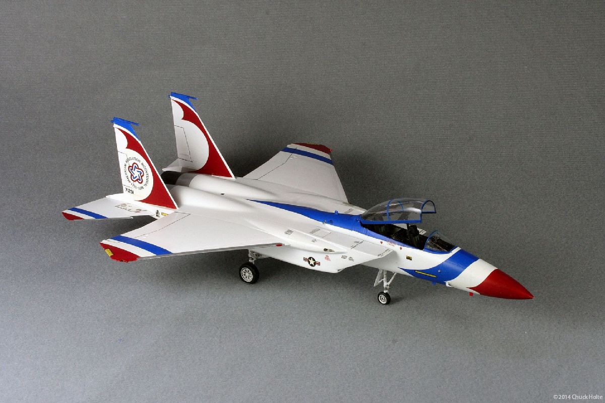

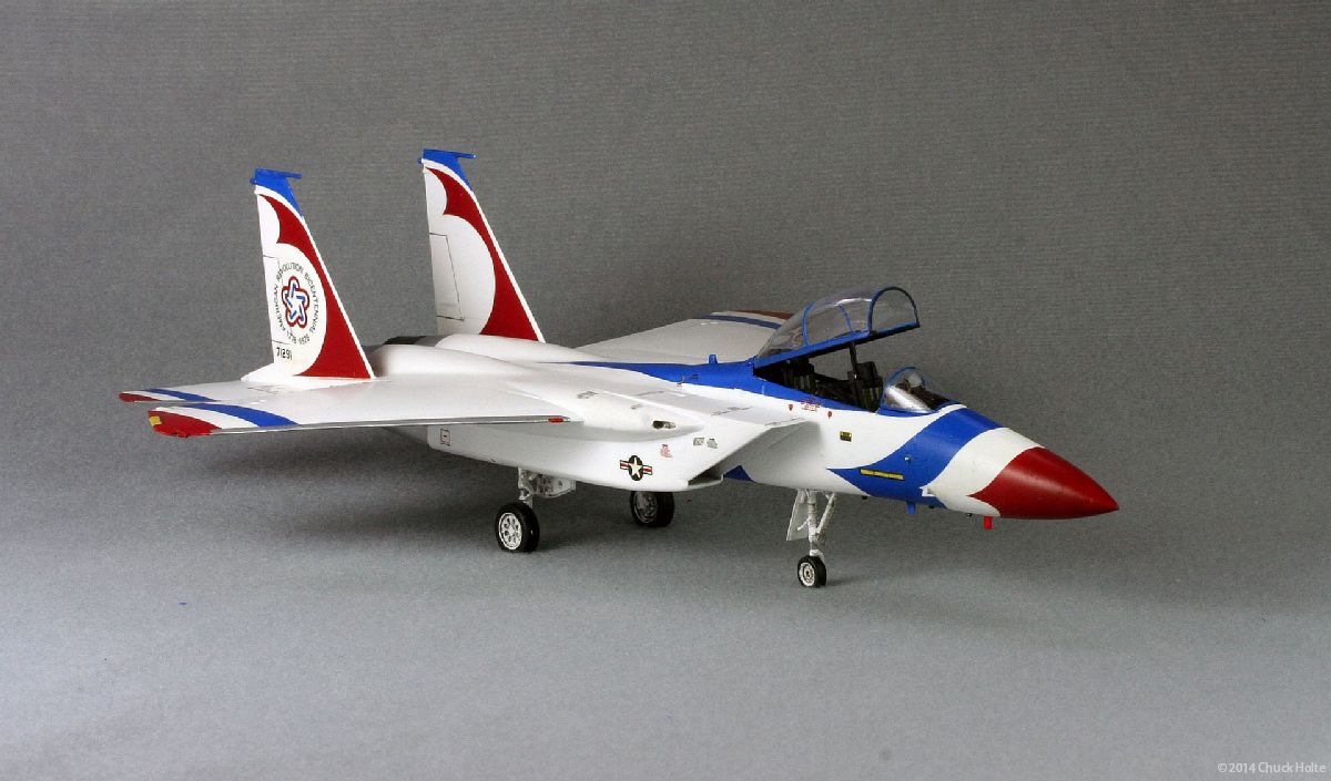

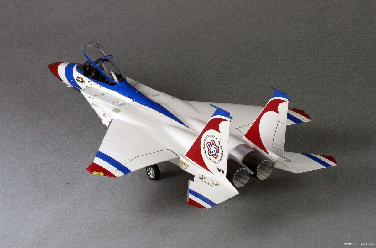

The basic kit is unchanged from other reissues of the two-seat Eagle. It suffers from a complex join of the forward fuselage with the aft fuselage behind the cockpit, in the midst of the engine inlets, ramps, ducting, and speed brake. A little patience, practice fitting and adjustment will be necessary to avoid an unsightly joint in that area. Otherwise the assembly is quite simple and only minor filling and sanding was required. Cockpit detail consists of high relief depictions of the various panels, screens, switches and detail that can be painted or decaled. I hand painted the front and rear instrument panels and used the decals for the side consoles. I found the kit's eight piece cockpit and four piece ejection seats fine for the scale, but some modelers may want the more detailed effect of available aftermarket resin and PE sets.
I primed the assembled model with rattle-can Tamiya Fine Surface Primer and then used Tamiya rattle-can TS-26 Pure White for the top coat. Alclad Aluminum was used for the hot areas of the aft engine bays and Model Master Gunmetal was used for the exhaust cans.
The kit's large red, clear and blue Hasegawa decals promised to ease a lot of complex masking and painting and generally "make" the colorful model. The decals were strong enough as they were applied and would stand a lot of coaxing, but I found them very difficult to work down into wrinkle free application over the gloss white lacquer finish. After much slicing and dicing to get everything to fit, I found they did not "stick" very well and would flake off at the slightest provocation, even with Micro Sol and Solveset. The nose was the worst – I ended up removing most of red decal and carefully matching the paint to airbrush the nosecone. Were I to do it again, I would use the kit decals as masking patterns and airbrush all the bicentennial markings. Granted, the decals were 10 years old, but they caused me a lot of grief on an otherwise enjoyable build.
After decaling, a final airbrushed coat of Floquil Flat brought back the desired finish.
I wanted a colorful Eagle model in my display case to contrast with the normal grays. The Bicentennial Eagle definitely fits that requirement and was overall an enjoyable build, but the kit decals were a lot of work. Recommended for the experienced builder due to the old decals.
